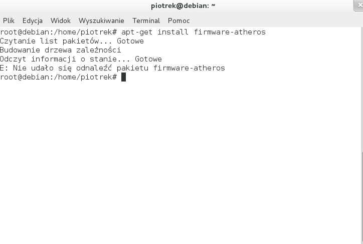

Mam Debiana Jessie i chcę sobie doinstalować sterowniki do TL-WN722N.
Wpisuję w terminalu :
Załącznik Zrzut ekranu z 2013-08-08 12:30:59.png nie jest już dostępny
A dmesg daje mi to :
[ 16.557546] r8169 0000:0a:00.0 eth0: link down
[ 16.557574] IPv6: ADDRCONF(NETDEV_UP): eth0: link is not ready
[ 586.398839] usb 4-1.1: USB disconnect, device number 3
[ 623.960703] usb 4-1.1: new high-speed USB device number 5 using ehci-pci
[ 624.070290] usb 4-1.1: New USB device found, idVendor=0cf3, idProduct=9271
[ 624.070302] usb 4-1.1: New USB device strings: Mfr=16, Product=32, SerialNumber=48
[ 624.070309] usb 4-1.1: Product: USB2.0 WLAN
[ 624.070314] usb 4-1.1: Manufacturer: ATHEROS
[ 624.070319] usb 4-1.1: SerialNumber: 12345
[ 624.071125] usb 4-1.1: ath9k_htc: Firmware htc_9271.fw requested
[ 624.076821] usb 4-1.1: firmware: agent aborted loading htc_9271.fw (not found?)
[ 624.077097] usb 4-1.1: ath9k_htc: USB layer deinitialized
[ 643.202005] usb 1-2: USB disconnect, device number 3
[ 725.265770] r8169 0000:0a:00.0 eth0: link up
[ 725.265793] IPv6: ADDRCONF(NETDEV_CHANGE): eth0: link becomes ready
[ 919.488657] r8169 0000:0a:00.0 eth0: link down
[ 1016.494382] r8169 0000:0a:00.0 eth0: link down
[ 1019.219259] r8169 0000:0a:00.0 eth0: link up
