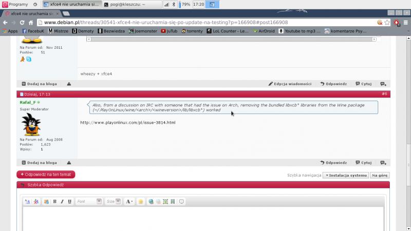

zainstalowałem gdm3 i śmiga, mam jeszcze teraz problem z openGL w playonlinux wcześniej wszystko działało jak należy a teraz :
err:wgl:has_opengl Failed to load libGL: /usr/lib/i386-linux-gnu/libxcb-dri3.so.0: undefined symbol: xcb_send_fd
err:wgl:has_opengl OpenGL support is disabled.http://www.playonlinux.com/pl/issue-3814.htmlAlso, from a discussion on IRC with someone that had the issue on Arch, removing the bundled libxcb* libraries from the Wine package (~/.PlayOnLinux/wine/<arch>/<wineversion>/lib/libxcb*) worked
