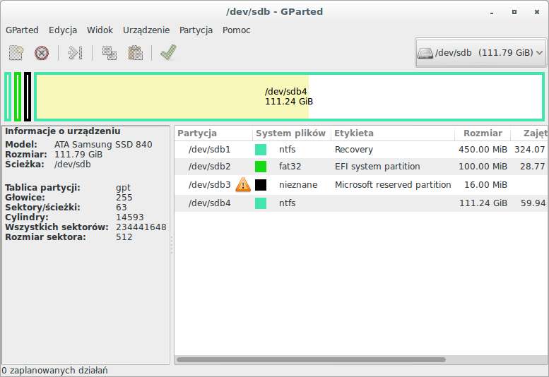

Mam problem z dodaniem systemu Windows 10 do listy rozruchowej GRUB,
Dysku z Windowsem (SSD) Dysku z Linuksem (HDD) Aktualizowania listy systemów GRUBa
Próbowałeś tak:
# os-prober
# update-grub

Boot Info Script 0.61 [1 April 2012]
============================= Boot Info Summary: ===============================
=> Grub2 (v1.99) is installed in the MBR of /dev/sda and looks at sector
1660192768 of the same hard drive for core.img. core.img is at this
location and looks in partition 135 for .
=> No boot loader is installed in the MBR of /dev/sdb.

sdb1: __________________________________________________________________________
File system: ntfs
Boot sector type: Windows Vista/7: NTFS
Boot sector info: No errors found in the Boot Parameter Block.
Operating System:
Boot files:
sdb2: __________________________________________________________________________
File system: vfat
Boot sector type: Unknown
Operating System:
Boot files:
sdb3: __________________________________________________________________________
File system:
Boot sector type: -
Boot sector info:
Mounting failed: mount: nieznany typ systemu plików ''
sdb4: __________________________________________________________________________
File system: ntfs
Operating System:
Boot files: /bootmgr /Windows/System32/winload.exe

Drive: sdb _____________________________________________________________________
Dysk /dev/sdb: 111,8 GiB, bajtów: 120034123776, sektorów: 234441648
Jednostki: sektorów, czyli 1 * 512 = 512 bajtów
Rozmiar sektora (logiczny/fizyczny) w bajtach: 512 / 512
Rozmiar we/wy (minimalny/optymalny) w bajtach: 512 / 512
Partition Boot Start Sector End Sector # of Sectors Id System
/dev/sdb1 1 4,294,967,295 4,294,967,295 ee GPT
/dev/sdb1 ends after the last sector of /dev/sdb
GUID Partition Table detected.
Partition Start Sector End Sector # of Sectors System
/dev/sdb1 2,048 923,647 921,600 Windows Recovery Environment (Windows)
/dev/sdb2 923,648 1,128,447 204,800 EFI System partition
/dev/sdb3 1,128,448 1,161,215 32,768 Microsoft Reserved Partition (Windows)
/dev/sdb4 1,161,216 234,440,703 233,279,488 Data partition (Windows/Linux)

Czyli Windows jest zainstalowany w trybie UEFI, a Debian w trybie BIOS?
Nie chcę tu niczego przesądzać, ale ... prawdopodobnie jedynym wyjściem będzie "przerobienie" instalacji Debiana na UEFI, a potem dodanie Win10 do menu Gruba wg tego (tam zresztą masz dodatkowe linki):
https://wiki.archlinux.org/index.php/GR ... menu_entry .
Dostosuj ewentualne różnice w nazewnictwie katalogów (grub/grub2) i tak dalej.
- marcin1982
- Posty: 1732
- Lokalizacja: PL
Dostosuj obecną instalację Debiana do UEFI:
http://tanguy.ortolo.eu/blog/article51/debian-efi .
Potem dodaj do Gruba2 wpis dla Windows10 wg porad z wiki Archa, ale zwróć uwagę na ewentualne różnice w składni poleceń Gruba między Archem a Debianem.
